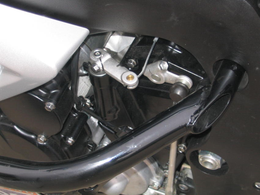

I actually didnt know that. I took some pics - they came out crappy but here they are. It looks like its hooked up right but you let me know what you think. I actually just bought the EZ pull system and I have the raptor ez pull lever so I'm thinking with both of these that it should be straight. Dont know if these pics even help at all but what do you think?

clutch cable is in the wrong hole. it's in hole (a) when it's suppose to be in hole (c). and yes hole (b) is in the middle.

it has to go in the hole closest to you ..and put the adjuster aiming towards it....(the thing that holds the cable...)

Yup your pics tell everything. Look how your cable is bent as it goes in the lever. If you put it in the other hole there will be a lot less tension on the cable and then you have a easy pull.

Thanks for your help. I'm gonna have it switched and see how that **** works out. I'll let y'all know.

I'm in the learning phase too but I feel myself getting better and better every day. Right now i'm just messing around with wheelies and stoppies - trying to get my wheelies slower. This past weekend was a good weekend - something clicked this weekend. Let me know if you wanna meet up though. I got a bunch of people that I chill with who are showing me things. And to everyone else - thanks for your help w the ez pull. It is like butter right now. I had my tech guy add the ez pull system w the raptor lever and switched holes and it is like butter. Appreciate all the help. I'll post pics later.
