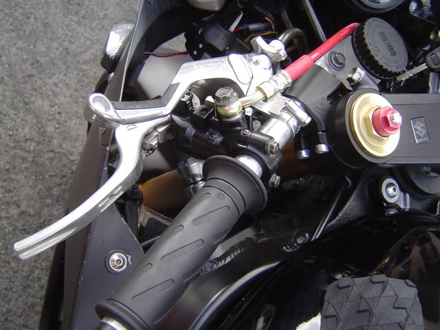

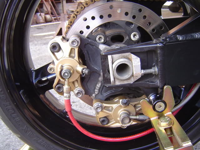

Okay, from what info I recieved from everybody on this fine forum. I too wondered about this. i.e.:What master? what caliper? dual caliper or full throttle? I came up with this set up. 05 GSXR 750 radial master (16mm bore), using a 84" brake line (-3), and running it to a 04 GSXR 1000 rear caliper (2 piston). Works great. I can lock it up no problem, but it's the feel that's the problem. I may flip the clutch lever and HB master soon. I don't have that shitty clutch lever in the pic anymore, got the MSR ProRaptor. My thinking on the HB issue, was stop thinking and go do it. :YEAH :YEAH :YEAH
I know it's welded up and it looks shitty, if it starts cracking like everybody says, I'll just breakdown and buy the 905 bracket.:YEAH
The problem is you probably won't notice it cracking, you'll just one day eat complete ****ing **** when it breaks off and locks up your rear wheel while doing a ss or something.
+1 **** that fix in now befor it cracks off

905s on order. But the whole MC thing. Anything w/16mm bore.
