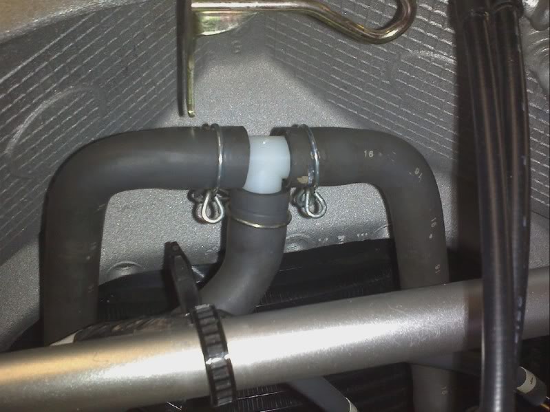

ok there are some 636 owners who have read this whole thread but didn't get it so imma try and explain this a different way
see the big hose in the picture above ,the one that has a black hose clamp on it and it isn't connected to any thing on one end ?
that hose needs to be connected to the big hose with the gold hose clamp on it in the picture below ,it also isn't connected to any thing on one end ..
ok now there is a little vacuum line in the first picture that goes to the back of the clean air valve thats the black plastic thing that the first big hose i talked about is connected to you need to take that little vacuum line off the clean air valve and put a long screw in that vacuum line and thats all you have to do to the hoses and lines..
the only other thing you have to do is plug the holes left in your air box that the two big hoses you connected use to go to....
you can replace both of those big hoses with one long hose or you can connect them in a number of ways but the objective is to by pass the air box....

steve i just do it that way incase there is a back fire or some thing ...
the stock hoses are less likely to blow off then the little caps are ..
even if the stock hoses blew off they wouldn't go any where so i could just hook them back up ,if the little caps blow off they always dissapear

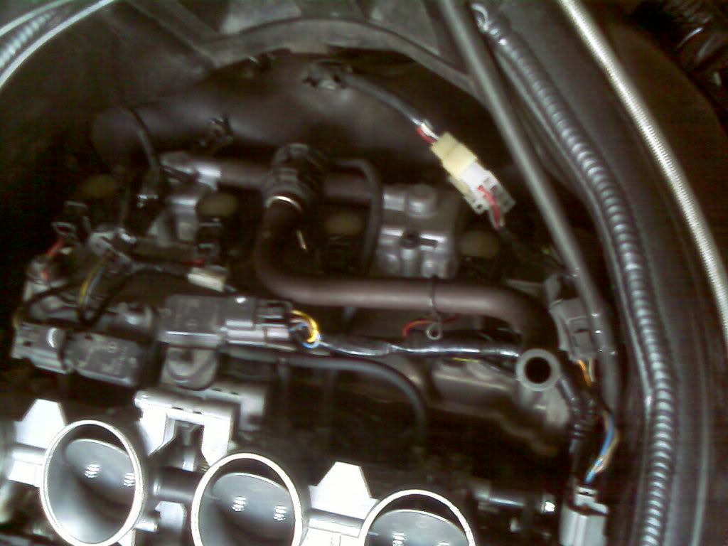

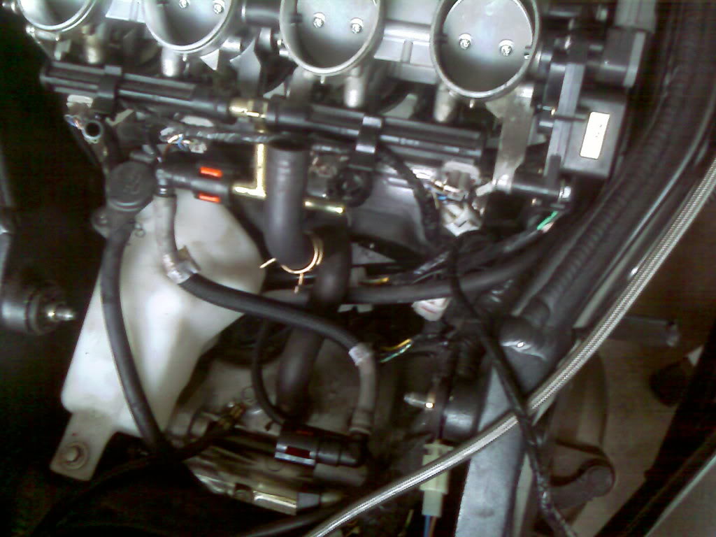

For people interested... here's a couple pics of the mod on the f4i:

I did the "Graves smog block off" mod on my R1. Is this basically the same concept?
I've seen it done where you take the reeds and flip em back words, and just cap off the hose lines. Then cap the old lines for the air box.
Are these 2 different mods? Or just different ways to do the same thing?
I want to do this for my 929, so any help is appreciated.
- Pixel -

that is a different mod this one is better because it creates a vacuum in the crank case and the other way creates pressure and thats really not a good idea

So on my 929... I "T" the hoses like in the pics, and leave the parts with the reeds in em alone. I plug the 2 holes in the air box where I removed the lines.
Are their any vacuum lines near the throttle bodies I'll need to cap?

yes, yes, yes, and no.
