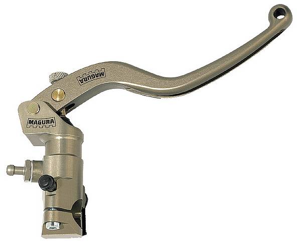

This is the Magura 13mm and its more expensive than the brembo.

Originally Posted by TOBY-
This is just my but i have rode alot of peoples bikes in the last few months
mine is pretty good 16x18 brembo supermoto short lever (636) b model
adzz f4i with brembo 16x18 brembo folding lever andgled up sliglty is awesome locks up with wedding ring finger
ghostie i dont know what he got now cos it was dark but was pretty good but i could not ride his bike for **** cos cut down clutch lever really gangsta short
but i have to say that
Lee's 13mm magura is the best setp up twin caliper adapter with 2 rear calipers from a 636 on his 636 c model it has loads of power and is the most progressive feel definatley the best brake set up i have ever rode with by a long way
so 13 magura all th way for sure
You know you loved it Toby:YEAH hehe when you gettin the c1h??
The Brembo IMO is just as strong, the difference is i have 10x more feel with the magura then any brembo. Its also 100x better with the duel caliper set up. I no longer have blisters on my finger from hours of riding and can do rev limiter ss coaster with ease.
I've rode with Brembo's i just dont like them. But saying that i'd get used to it if thats what i had to use.
