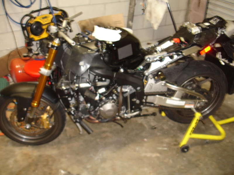

Exclamation It's alive "HONDASAKI" 600RR AND 636 ORLANDO MADDNESS
blown motor....
good news is that the 636 front end and wheels fit niceley...

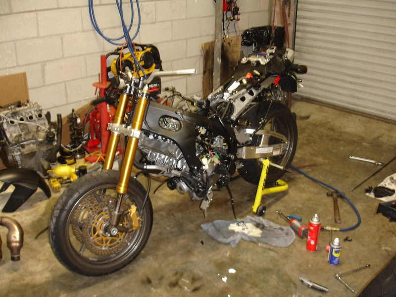

bad motor out..

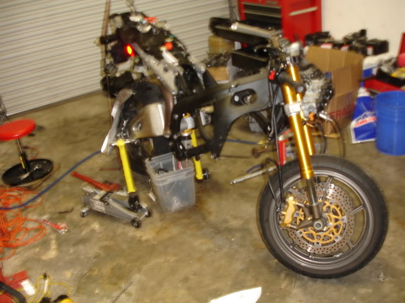

new motor in. its the start of a new life..

636 rear rim mounted right up to that thing?

nice ...strong honda frame and the best forks kawi ever put on a bike..
and those newer kawi wheels are light as a feather..
i would make the kawi rear pegs fit on there if i was you they are way longer then the honda ones

nags- yea little shaving of the 636 wheel spacer
roger-good call i havent looked to see if they are even close.

no the original 600 rr honda motor was blown!!! i just put another 600 rr motor in.

is the radiator going to fit? it looks like it might be close to the front

You used the 636 triples ? Was it a direct fit?

whats weird is the 05+ stem is shorter and smaller diameter at the top and looks like hes useing the 03/04 top bridge which will leave like a 1/2 CM gap in the stem hole..
and those are def 05 forks cause those rotors wouldn't work with out spacing the calipers.

i think the radiator was just droped when i took pic.
i used 929 upper and lower clamps. used 3m shipping tape to make up the diffrence in the lower clamp because the 636 forks are not as thick (out side dimater) as the 929 but the top clamp was perfict. rubber mallet with a few swings and it fit snug...

u should of disected a few pepsi cans and use that as a sleeve insted of tape
+1 Or something thats a bit more solid.
