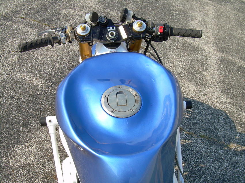

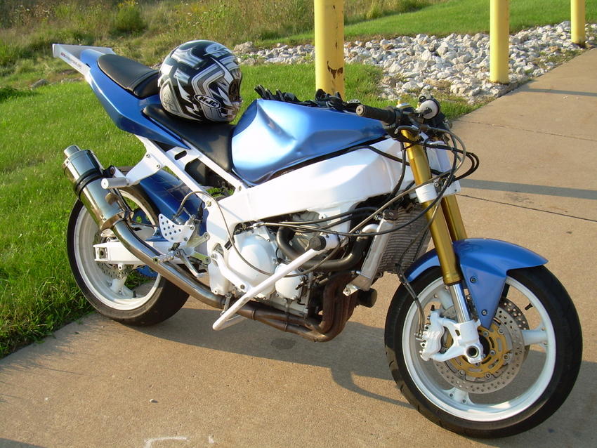

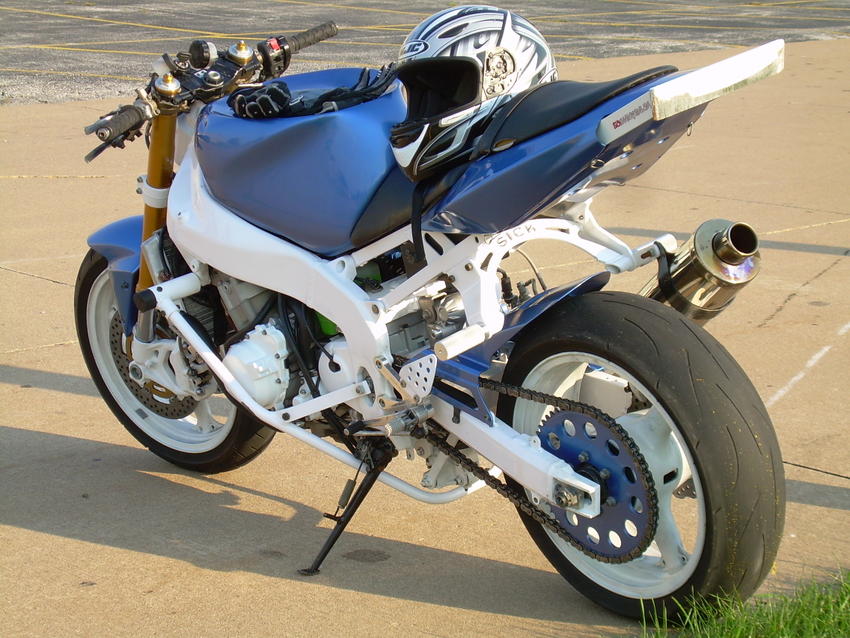

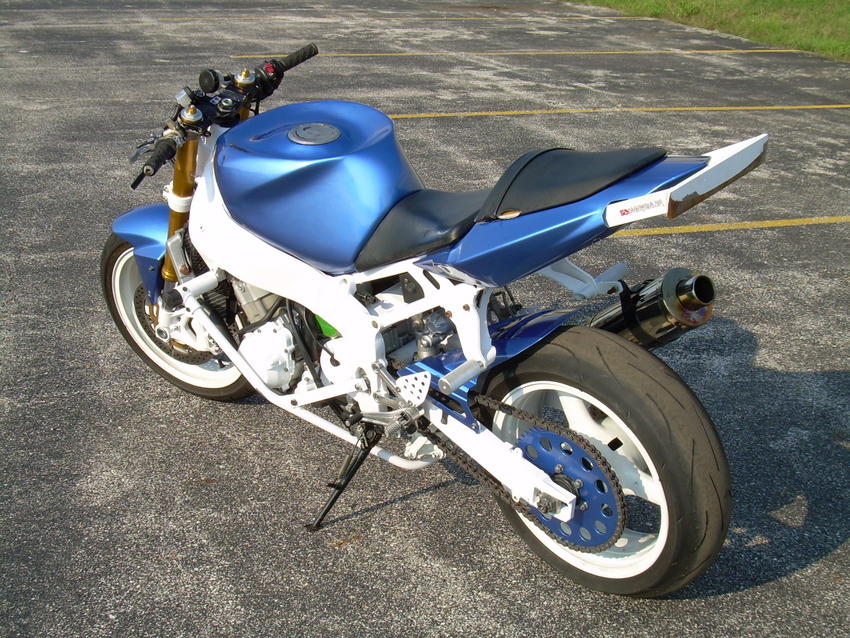

well i got my bike all back together from my lask wreck, sent everything out to get powdercoated and i did the paint job myself !!!! i just recived my johnnyp upper stay today in the mail and now ill put on the race upper & lowers!!!!! i took it out for about a hr at the lot and so far so good!!!

the paint looks real good
what'd you use to paint? i'm wanting to paint mine real bad

i already had a air compressor in my garage so i went to harbor freight and bought a cheap *** hvlp gravity feed paint gun for $20, in line filters $12, 2 stage demension paint from sherwin williams automotive paint $85, paint reducer $16, can of paint hardner $10, and a sheet of plastic to make a getto *** paint booth in the garage for $4 so i pretty much did it all for about $150 bucks. and i love the fact i did it on my own.

painting is the easy part, all the prep work is what makes it come out good.
take your time with all the sanding, or else your going to be kicking yourself in the *** later.

Bike looks sick dude, loven the white on blue
Originally Posted by zxcraig
in line filters $12
Where did you find these? did they filter out moisture and how well?

they are small round plastic in line filters. i screwed it into the bottom of the gun & ot worked out great. traps the moisture and prevents fish eyes in the paint. almost and automotive paint shop had em and lask week i seen that oriellys also has em.
