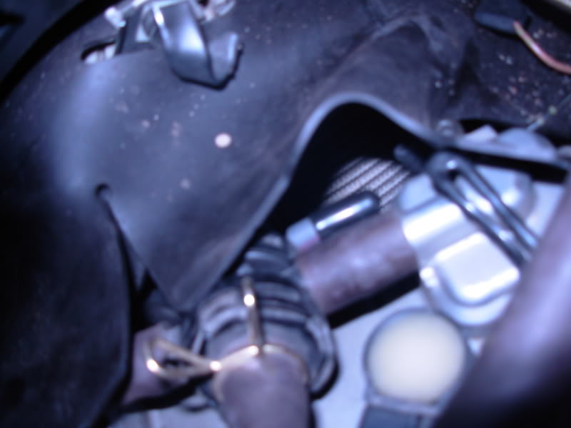

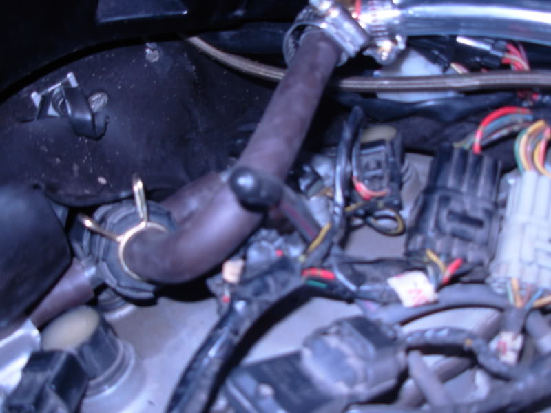

So i did the mods and still got one question. The vacuum lines that come off the throttle bodies, do they need to be removed? i was looking at them and they are all connected so i dont believe they would have to. the only one i kno i had to cap off was the line that went from a throttle body to the stock "t" fitting. I took some pictures of my ghetto rigging so if omr or someone else could give me the okay to go, it would be great. sorry bout sounding like a 2 year old, but im a stunt rider on a tight budget, the less that goes wrong the better!

noglory you only need to plug the one line but i suggest you thread a long screw in the hose because those little vacuum caps always either blow off if the bike back fires or they get hard and crack , that causes a mystery vacuum leak that is a bitch to find

no thats fine but if your bike starts to idle up and down for no reason that would be the first place i would look
