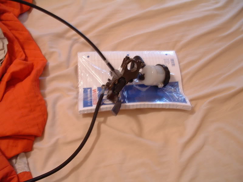

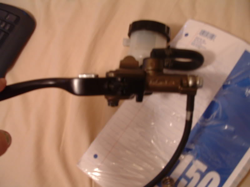

Do i hook this **** up?? Looks to me Like Cin-O-Nasty Sold me a ****** front brake when i was supposed to get a rear brake...

just mount it upside down like every one else does and get a longer hose for the res....

Re: How The ****??
oh lol k i thought i just wasted a 130 ****** dollars

Re: How The ****??
no, most people have a front master for a hand brake ...
i alrdy tried to mount it up side down im goign to have to grind 1 screw down, but it seems like the clutch is all in the way

Re: How The ****??
some master fit better then others but yes some times you hav eto do some grinding to get it to fit like you want it...
i like the brake lever on the bottom and closest to the inside with the clutch on top closest to the out side that way you get the most leverage on the brake and you can work the brake with your middle finger and the clutch with the index finger

Re: How The ****??
ok so i have another question does the brake line hook directly to the calip im still waiting for my adapto from Hai, but the brake line isnt long enough i was told i could hook it right up once i got that adaptor

Re: How The ****??
the adapter goes into your rear master cylinder [the one by your foot]
and then the line from your hand brake master goes into the adapter..
the adapter goes in where your res for your foot brake is..
old man roger is offline

Re: How The ****??

Re: How The ****??
oh nvm so the res by the foot brake it goes to that?? then the line is long enough
